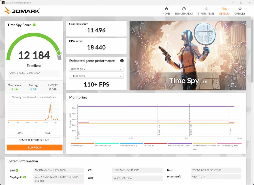

+3.9% sur le benchmark 3D Mark Time Spy.

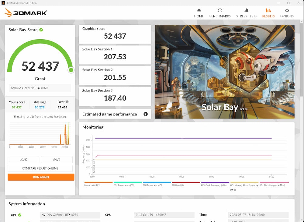

+4.3% sur le benchmark 3D Mark Solar Bay.

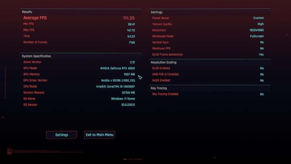

108.69 FPS soit +2.4% sur Cyberpunk 2077.

TimeSpyScore11’72712’184??
  +3.90%??
Solar BayScore50’27852’437??
  +4.29%??
Cyberpunk 2077FPS108.69111.25??
  +2.36%??
